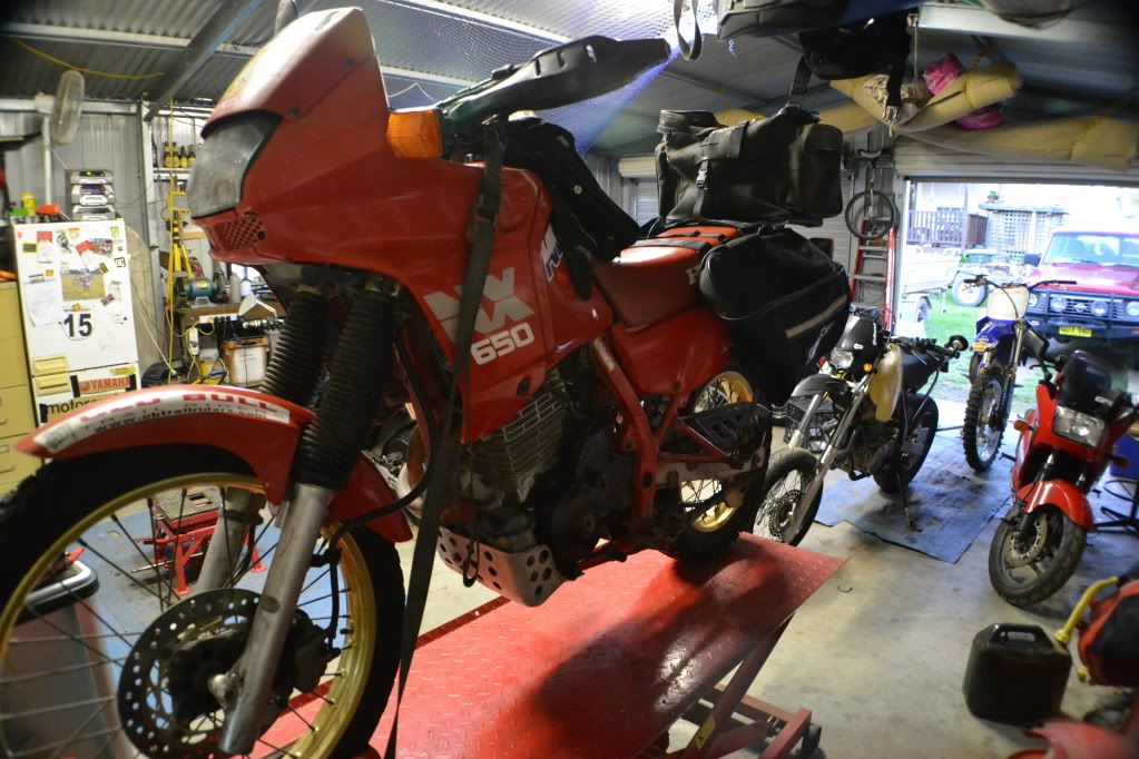

    She’s certainly got a wild paint job Pezz!
    Work on the NX has begun in earnest, last night tried working out how the luggage system is gunna go on and hopefully stay on. Has anyone got an old Gearsak rear rack kicking about???

    Spent a few bucks on the NX today and got a screen made up for her. I heard it gets cold down that way. This is the prototype screen. I will give her a test run before we leave. $40 at the local plastics place. I just made a template out of a beer carton and they did a great job copying it..
    #218151
    Looks good Mick, it may pay if you take it back for a tweak like you said on the phone to have the top lip curled up to kick the wind up and over at the end ;)
    #214815
    Tweak it for sure ;)
    Preliminary job looks the goods though Mick ,,,
    I mounted a Kato Hardparts screen to mine last week, it has a kick in the top as well for that little bit extra deflection of the air :whistle:
    Test rides are always a great excuse to get out too :P
    #218152
    my design allowed for the top 3 inches to be tweaked if necessary. ;)
    #218153
    Just the last inch or even half inch Mick, any more isnt needed and will put to much pressure on the mounting screws I reckon ;)
    #214816
    Yep,
    It only needs a small kick to be effective, half inch should go close,,, you have a big area of air being directed upwards as it is with the screen size mate
    #218154
    I know this may sound silly but try and get some plastic, yes plastic screws. If you use plastic screws, when you go over the hangers or hit the screen and it does happen you dont smash the new screen, the fairing its mounted to and cut your throat :laugh:
    The teneres use plastic screws, yes I said plastic
    I have some spares I maybe able to give you they look the same size from memory B)
    #214817
    Nylon fasteners are relatively easy to get hold of,,,
    Think I have some downstairs actually… I can post you some Mick if ya like ;)
    Will check the size and get back to ya (think they are 6mm dia)
    #218155
    6mm is what I need. Three are metric thread but the forth is a self taper that some wood duck put in there in the past. Nothing is ever easy when dealing with older bikes! :laugh:
    #218156
    Yeah they are 6mm
