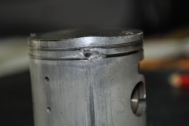

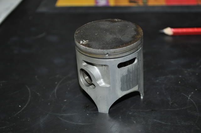

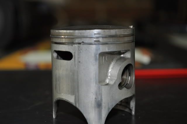

    #173932
    Mr Blue wrote:
    Your photos are pretty ordinary considering your profession Michael!!!
    Sorry Bruce that is the difference between a $99 trail camera that lives in my Camelbak and my $2000 media camera I use at work. Here are some better pics.
    Note the wear on the side below the port and a piece of ring embedded in the crown.
    I think that is the end of the ring embedded into the side of the piston 180 degrees around from the pin.
    And another pic for good measure
    #173963
    piston004.jpg[/quote]
    Is that the pin is located?
    #173964
    No 180 degrees around from the pin
    #173965
    So this has happened 180 degrees from the ring opening?
    #173968
    YEP…… :(
    #173969
    The break in the ring 180 degrees from the ring opening has been because when the ring was installed on the piston a weak point in the ring was created as the ring was stretched open to go over the piston. The weak point has given way after a short period the broken ends then get caught in the exhaust ports etc because there arent supposed to be ends there which is why the have locating pins.
    Not anyone’s fault really, as you expand the ring to get it over the piston with your thumbs or circlip pilers you dont want the ends to scratch the pistons so maybe you over expand it. I see this in oil consumption complaints all the time broken rings 180 degrees from the opening and when failure analysis is completed it is always the cause because as you expand it, it expands in one point, get a ring old or new and do it and watch it. We have special ring expander’s at work now I will take a photo and show how they work the whole of the ring not just opposite the opening
    Hope that helps Mick
    #173970
    It must of had some piston slap :dry:
