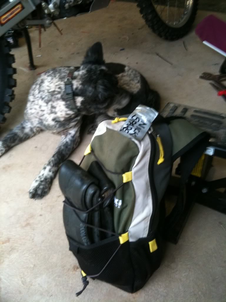

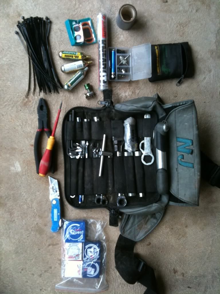

    Spares kit for Drz includes
    HD front tube
    STD rear tube
    2 counter shaft seals and o rings
    Air filter
    Skins
    Air filter oil
    Air filter rim grease
    Chain oil
    Helmet spares
    Spoke spanner
    Grips
    Hydro pack mouth piece
    Brake pads front and rear
    Bumbag
    Tyre valves, pressure gauge,repair kit
    Co2 bottles and adapter
    Instant metal
    Duct tape
    Cable tyes
    Chain and links
    Wheel bearings
    Hand pump
    Chain breaker
    Spanners
    Mini t bar set
    Combo pliers
    Screw driver
    Knife

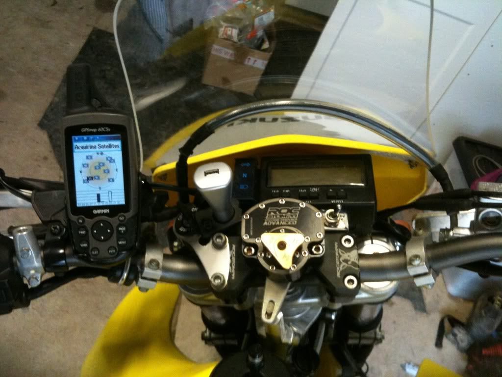

    The Cockpit with new Gps and mount ,charger socket and cut off switch

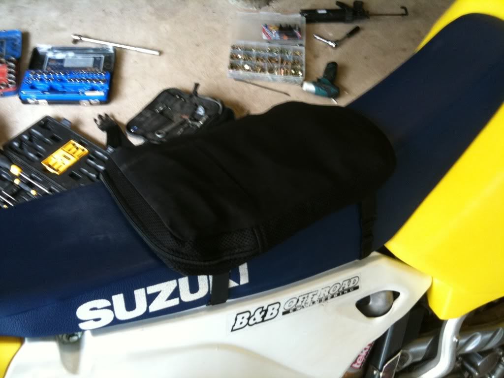

    The airhawk seat

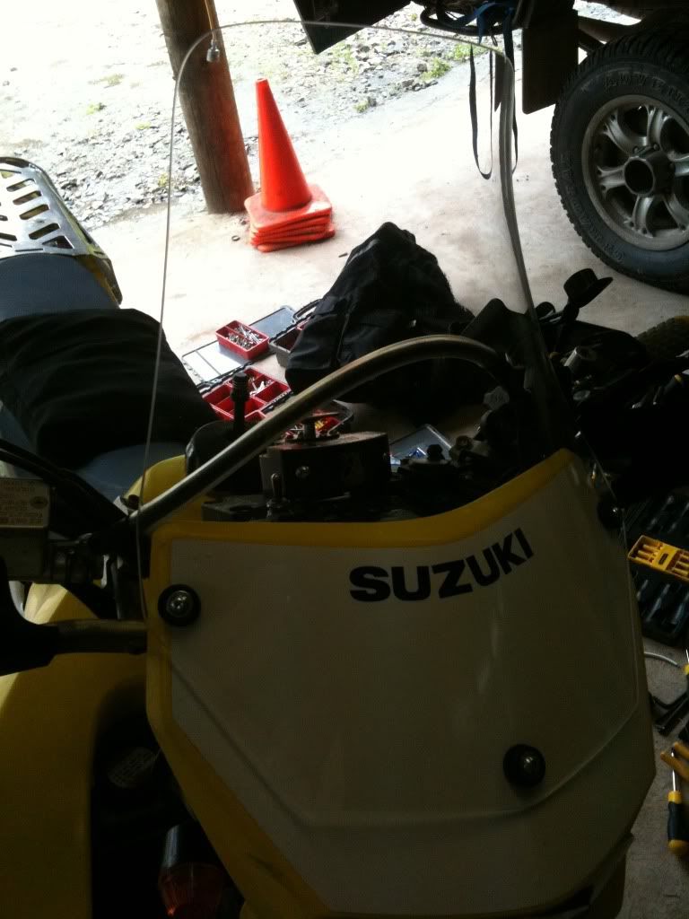

    the screen

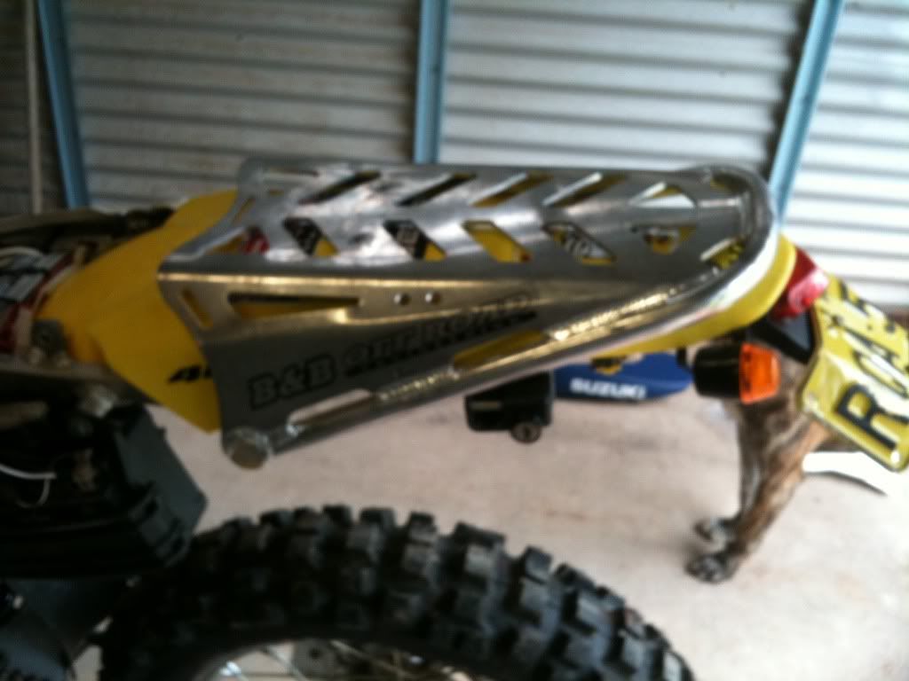

    the rack

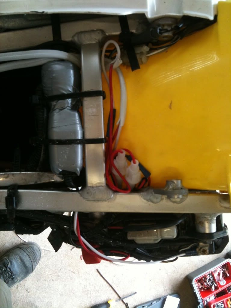

    underseat wiring with seperatly fused charger socket and gps
    #188269
    Hey nick, dont forget to pack a couple of spare 20amp fuses for the main fuse for the DRZ, mine shorted at cells and the bike just stopped(2 wires under the seat wore through), :ohmy: there should be a spare in the standard holder,butI recon getting a pack of them and chuck them in your bum bag. ;)
    #188271
    thanks Boony, I acutually blew my main fuse yesturday moving the horn and had to use the spare. I had totally forgot to replace it too. :huh:
