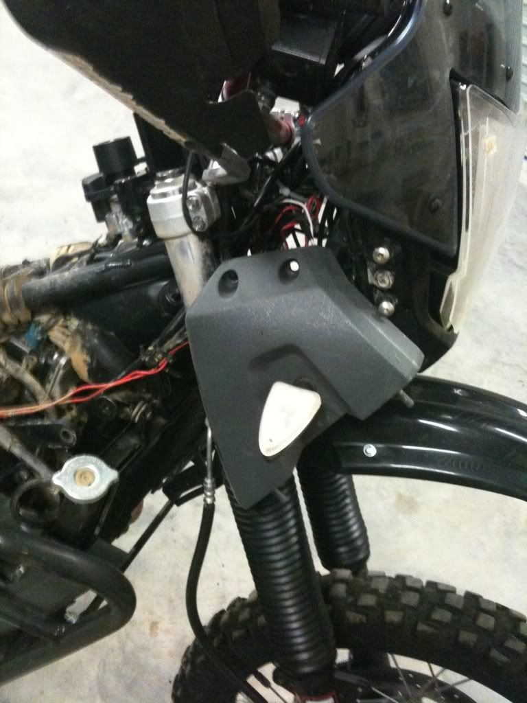

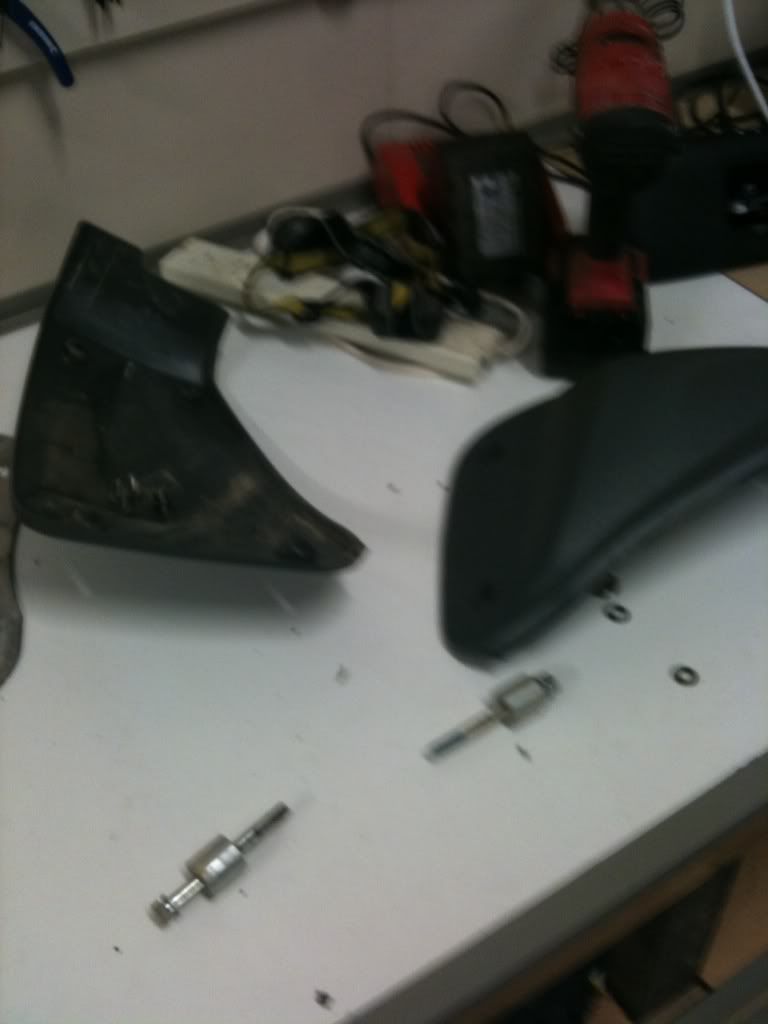

    Remove side plastics and indicator plastics
    Remove seat

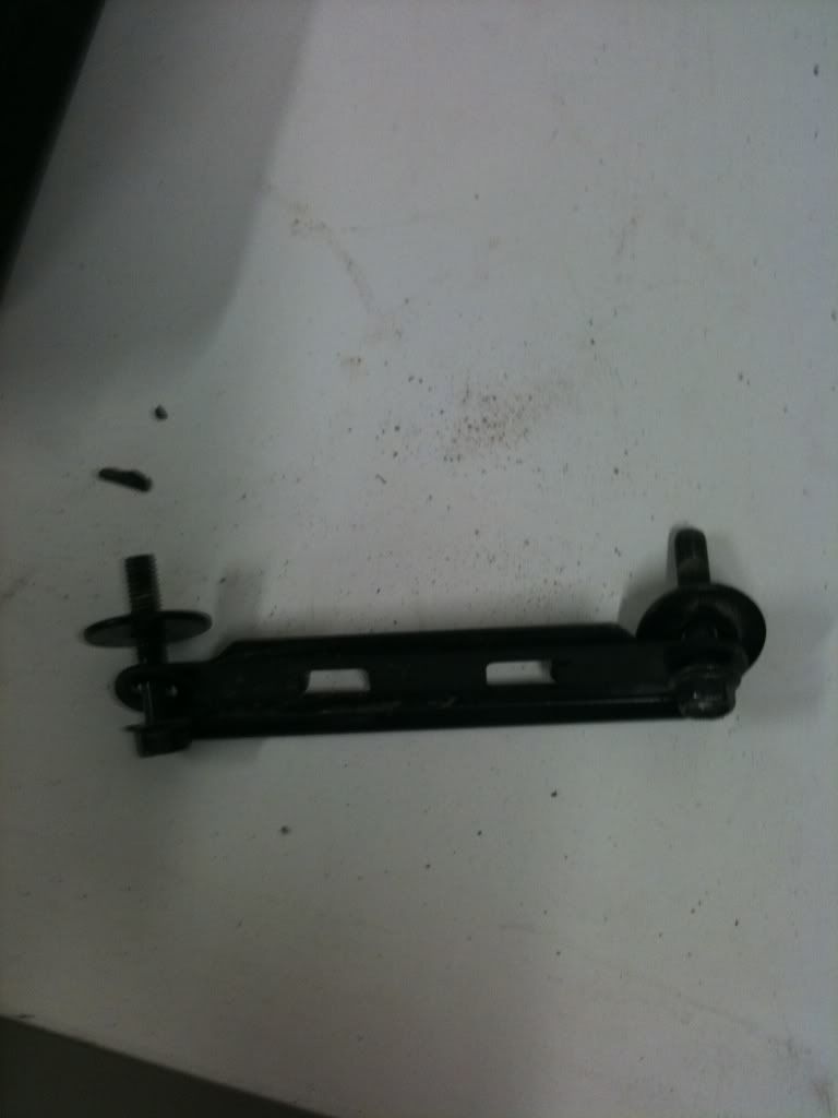

    Remove flat tank bracket under seat
    Remove tank bolts behind radiator , if crash bars have been fitted remove spacer with the bolt.
    View with crash bars fitted

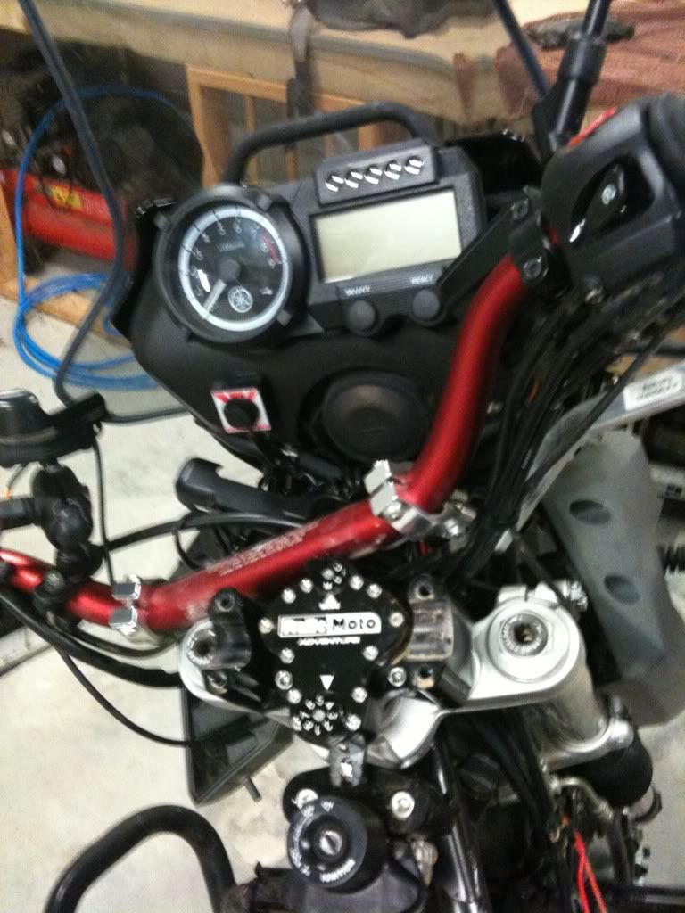

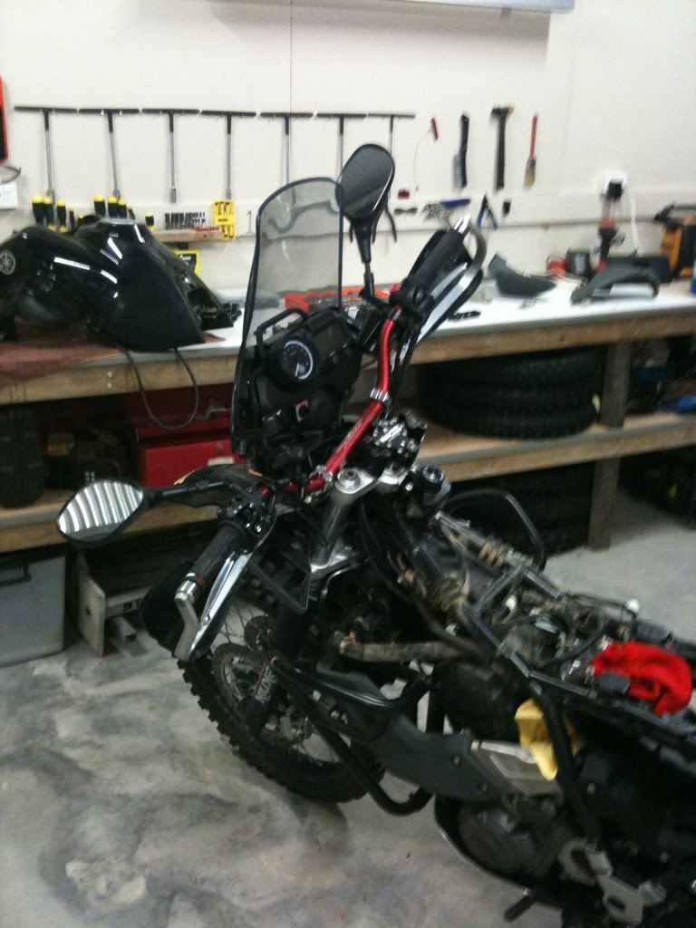

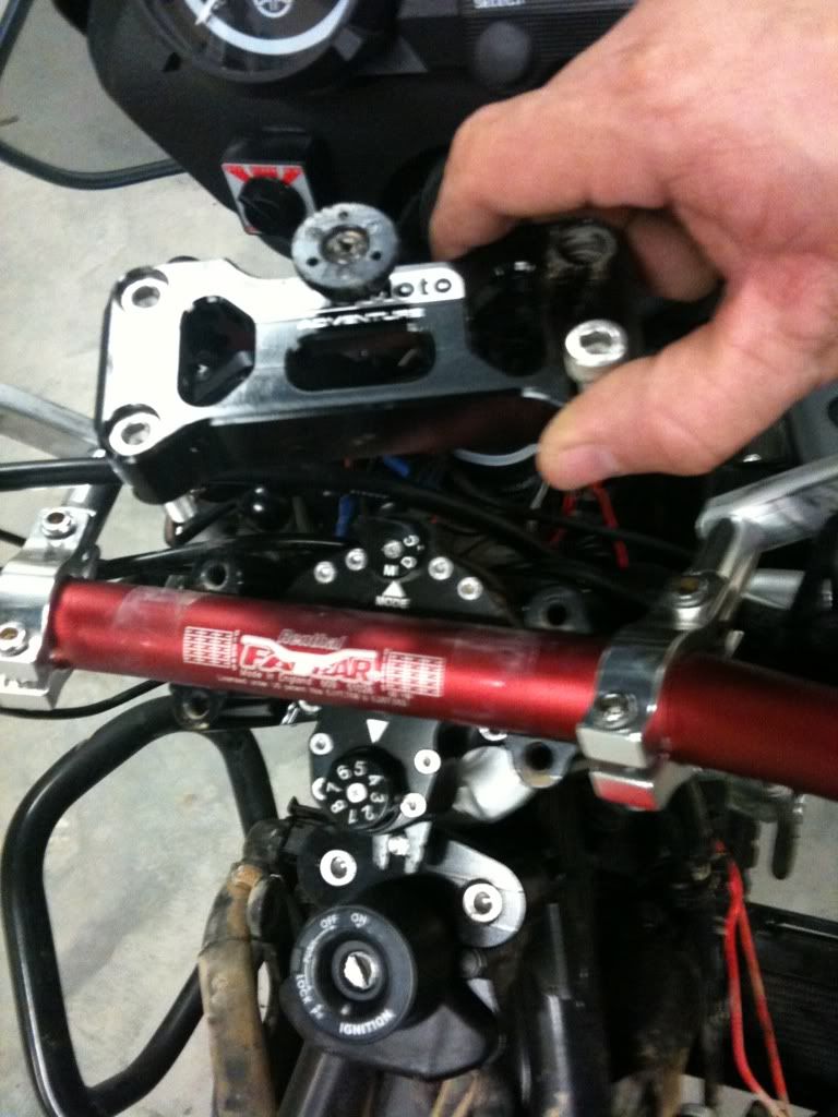

    Remove handle bars and lay forward

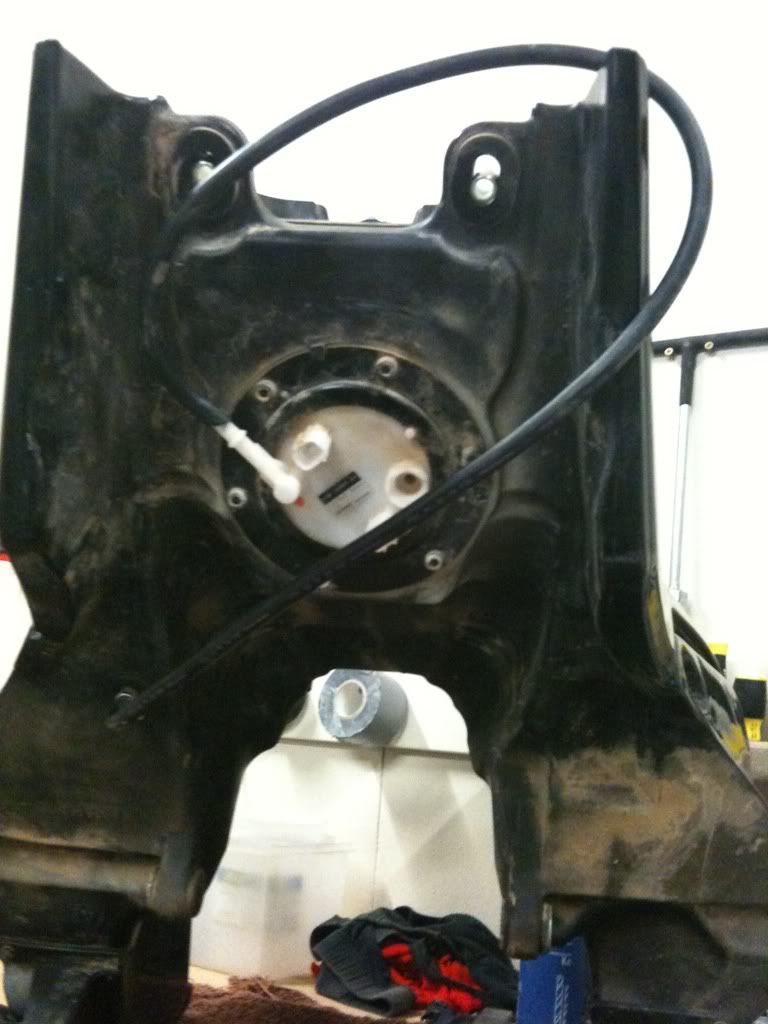

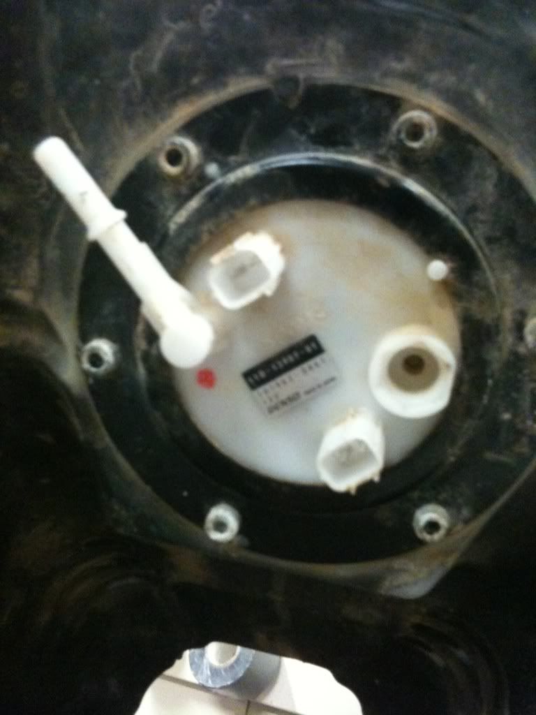

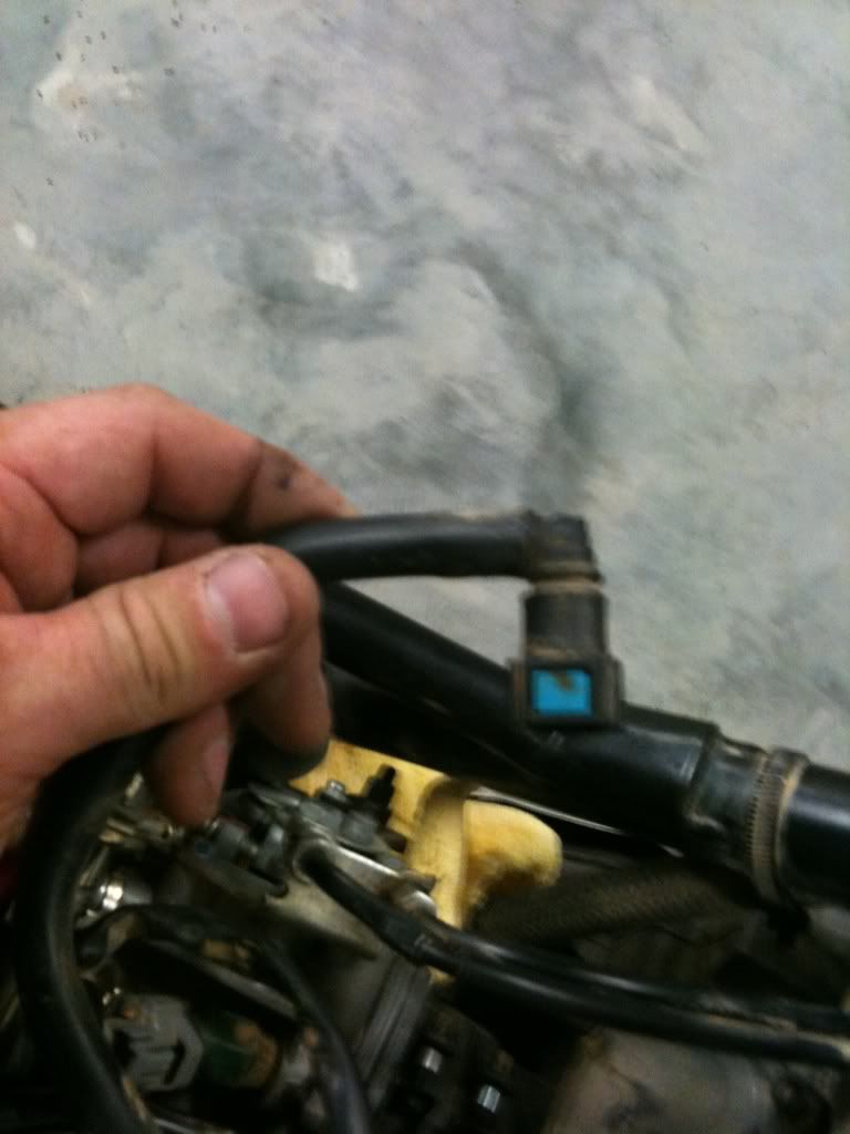

    Disconnect fuel pipe underneath tank
    Unplug sensor wires
    Remove tank over flow pipe or pull up with tank
    I had no fuel run out of the tank outlet pipe but as their is no tap I used the overflow pipe and pushed it on the outlet to be sure.

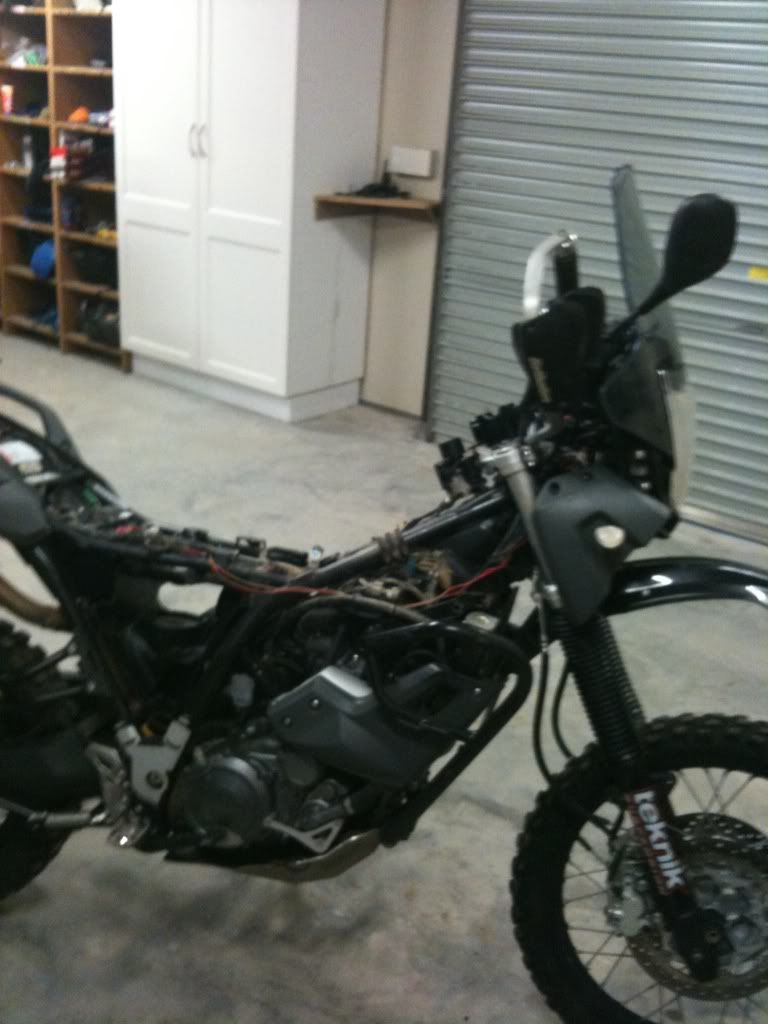

    Lift off tank
