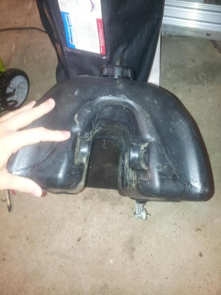

    TB’s legend status remains intact . The hero’s reply to a damsel in distress got the fuel tank on in about 5min flat. Even with his poor leg in that brace too !
    Unfortunately, I didn’t get a shot of how he did it.But it involved a large philips head and a flat head screwdriver. One to find the bolt hole and the other for leverage against a random bit of bike to push the tank forward enough to get the screw in. Excellent little trick. B)
    Now its just a matter of putting all the plastics back on and waiting for the rest of the parts.
    Here are the rest of the pics I’ve taken
    as you can see it needed to come forward a touch
    These were the rubber bits that the tank rolled on. TB pointed out that you must need a bit of force to get the tank on bc the rubber is distorted
    It slides on here
    So TB put a large philps head in the hole on the tank (red arrow) and through the hole on the frame to line it up. Then used a flat head as a lever (blue arrown) to push it into line. Then he removed the philips head and whacked in the bolt.
