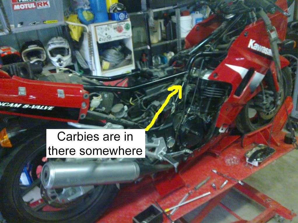

    My sister inlaw has asked me to sort out her GPX250 that wont start. It has been sitting in the shed for about 2 years. I have narrowed the problem to it not getting fuel. (it starts on ether) So I am going to have to pull the carbies out and give them a clean. Anyone got some recommendation as to a good carbie cleaner to get rid of the varnish or what ever ails the carbies?

    Thanks TB, now I just gotta work out how to get the carbies out. Man road bikes are a pain in the arse to work on!! Fairings and all that shit to come off before you even get to see what you are up against!

    Got the carbies out and stripped down, hit them with the magic spray and after my head stopped spinning from the fumes, I put the carbies back in the bike. Hit the button and it fired straight up! My excitement was short lived though, as it is still bogging at low revs and wont run with out the choke on , although it revs out fine up to 14,000 rpm. So it appears there is still an issue down low and the revs fluctuate at idle. Any ideas were to go from here?

    It is a bit of a pain in the arse to get to the carbies and then get them back in, only to find that it all has to come apart again. It isn’t a 5 minute job to even get to the carbies, let alone get them out! The carbs on this bike are even hooked up to the bikes cooling system and you have to disconnect water lines as well as the myriad of other rubber hoses.
