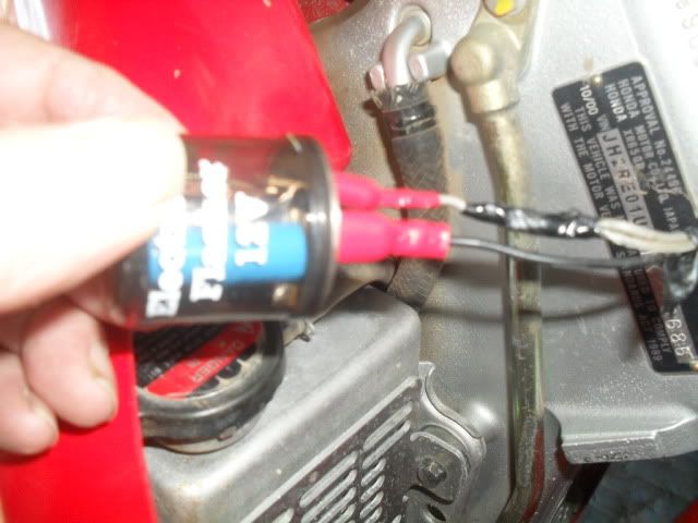

    Just got a set of slimline LED blinkers for the rear of the XR. The standard ones are still on the front. I have hooked them up to the correct plugs and they light up but dont blink nor will the front blinker. The test light blinks and so does the front when put in the plugs.
    The LED ones appear to have what I am assuming is some sort of tiny in line resistor or something on the power wire.
    What am I missing?

    From what I can work out from that thread,I need another resistor? Why the hell dont they come with one or some freaking instructions at least??

    Got it sorted!!! All I needed was a 12V electronic flasher can to replace the existing one…..$28
    #161008
    The black wire is earth, fuse the other two together and plug them to the + side of the flasher.

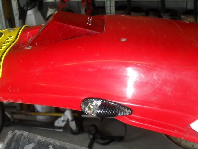

    Post some pics of the blinkers Mick. I’m starting to look around to get some for the Sherco.
    #161012
    Here they are Mal, we have fitted the same here, funny enough also we don’t nee to use the flasher can arrangement as the they have worked this morning now the battery is charged and we aren’t looking through the bottom of a rum can maybe :laugh:
    Mal @ Sutto’s hooked up all the parts for the motard project and I gave those ones to Moose the other day from Mal for Mick to try before he buys.
    #161013
    They look the goods TB. I might grab a set on our next lunch date in a couple of weeks. I had smaller single LED on the Sherco, but they weren’t very bright. They look like there is 6 or 9 LEDs on them. Nice.
    #161016
    Mine are a bit different. I think they are about $35. They look pretty bling with the carbon fibre look.
    Dunno how long they will last before I kick one off with my boot getting on the bike.
    #161017
    They are the ones I had Mick. They lasted well. They only broke when I tried to get them off to put the new guard on. Not very bright but they look flash.
