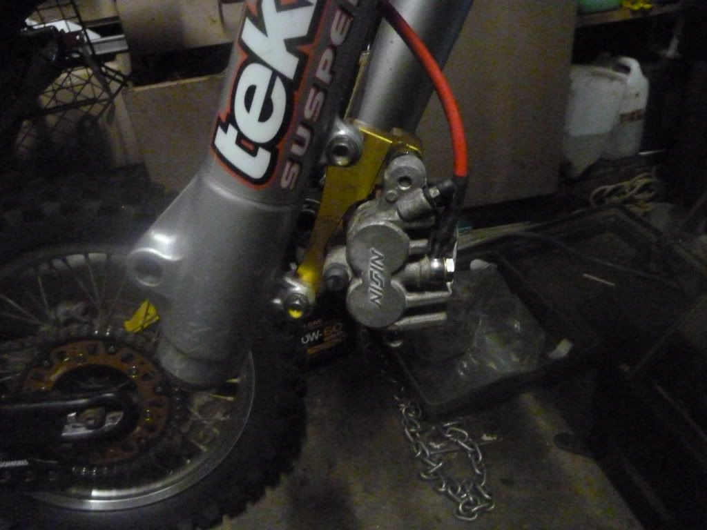

    As you all know I bought myself a BRP for adventure type riding and for the longer trail rides. I got a really good deal on a 2002 Model (late 01 Build) XR650R I paid $3000 and it came with a spare set of wheels with new Pirelli road rubber. B) The bike had 20000 kms on it but these donks are renowned for their longevity so not really an issue for me.I did however fit a stainless steel re-usable Oil filter and used Penrite HPR15 gas Oil. Anyway here are some photies of the build. I have also purchased a Clarke 16 litre tank and will get a new top triple clamp and fat bars to improve the steering. A Unibiker rad guard was also fitted,great protection but a prick to fit.

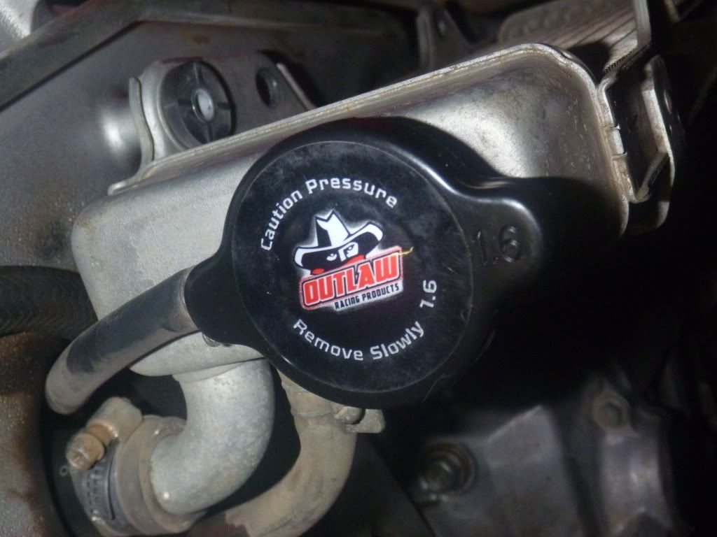

    Outlaw 1.6 Bar High Pressure Rad cap needed on the BRP

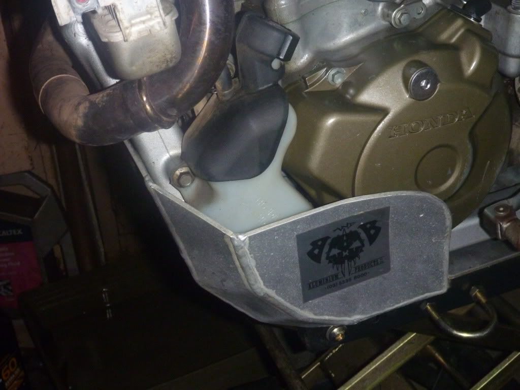

    B&B bash plate from Ebay $65 yipee!!

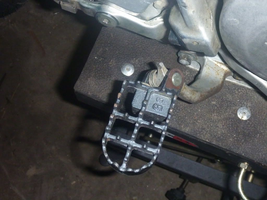

    Checked and loctited the shit front Bolt of the RH footpeg and greased the Kick starter

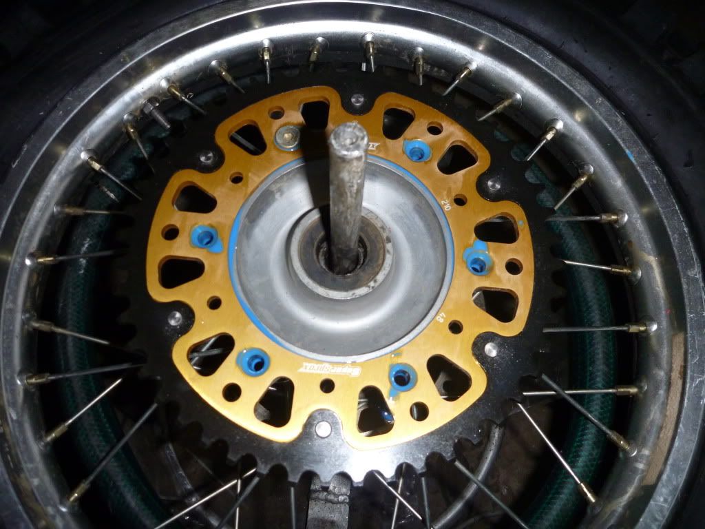

    stealth 48 tooth rear and renthal 14 tooth front sprocket matched to a new EK oring chain

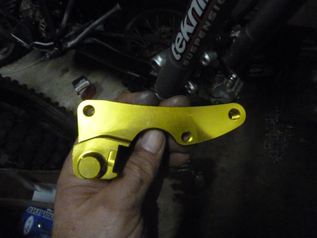

    Quality EBC O/sdisk bracket nice Bling

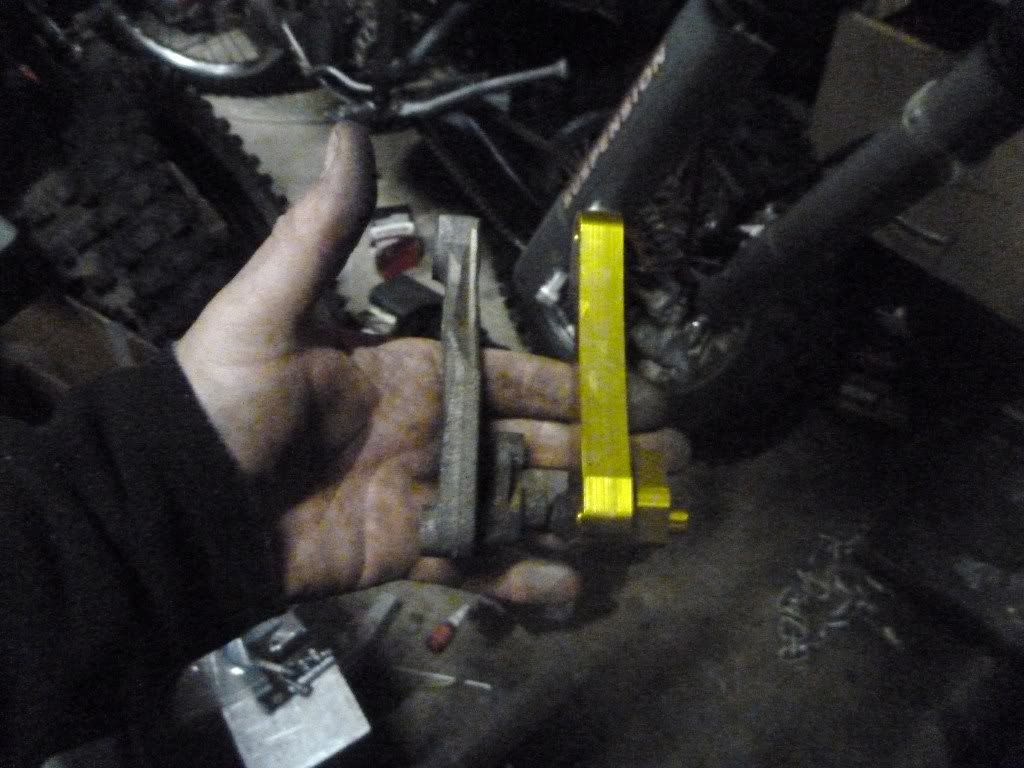

    check the difference from standard to o/s
    all fitted up and a plug for a sponsor lol
    New retreads front and rear and 280 mm oversize Disk (standard 240mm WTF)

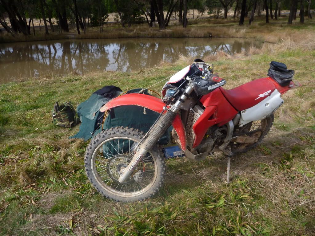

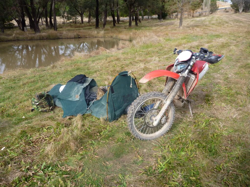

    Feel the serenity Suny corner camp site
    It was quite here except Kram was on one side and Tiny the other !!

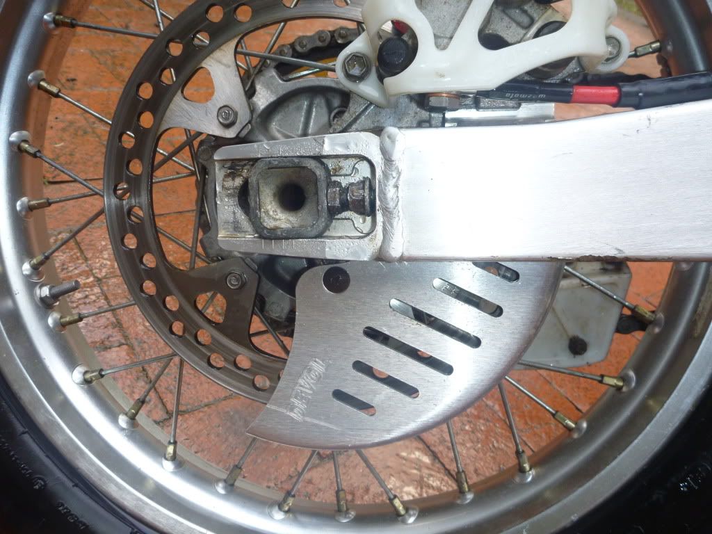

    Devol rear disk Guard better than the standard plastic POS

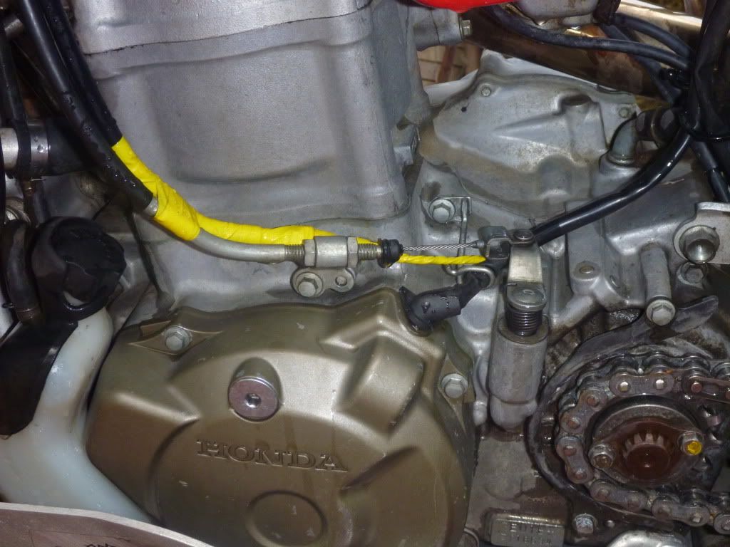

    I put in some standby clutch and throttle cables

    who’s hand is in the pic….
    too many fingers to be yours mate :P :laugh:

    Menace wrong hand, the right one is missing the digits the left is my modelling hand :laugh:
