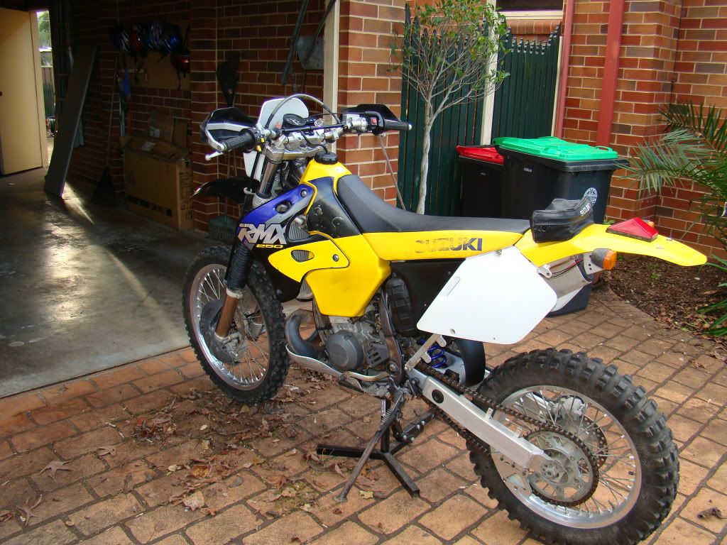

    I’ve had my eye out for a while now looking for a shed project. The plan was to find a suitable two stoke that would make a fun bike and possibly replace the DRZ. I’m toying with the idea of getting an adventure tourer next year and to afford that the DRZ will need to find a new home.
    The problem is I could not live without a proper dirt bike. I have been searching all the usual online sites to find a cheap earlier model two stoke. I have looked at some Huskies and almost won a neat 2002 KTM250EXC on Ebay.
    I looked at a number of RMX250S and thought I had worked out a deal for one. Most I have looked at are well used or over priced.

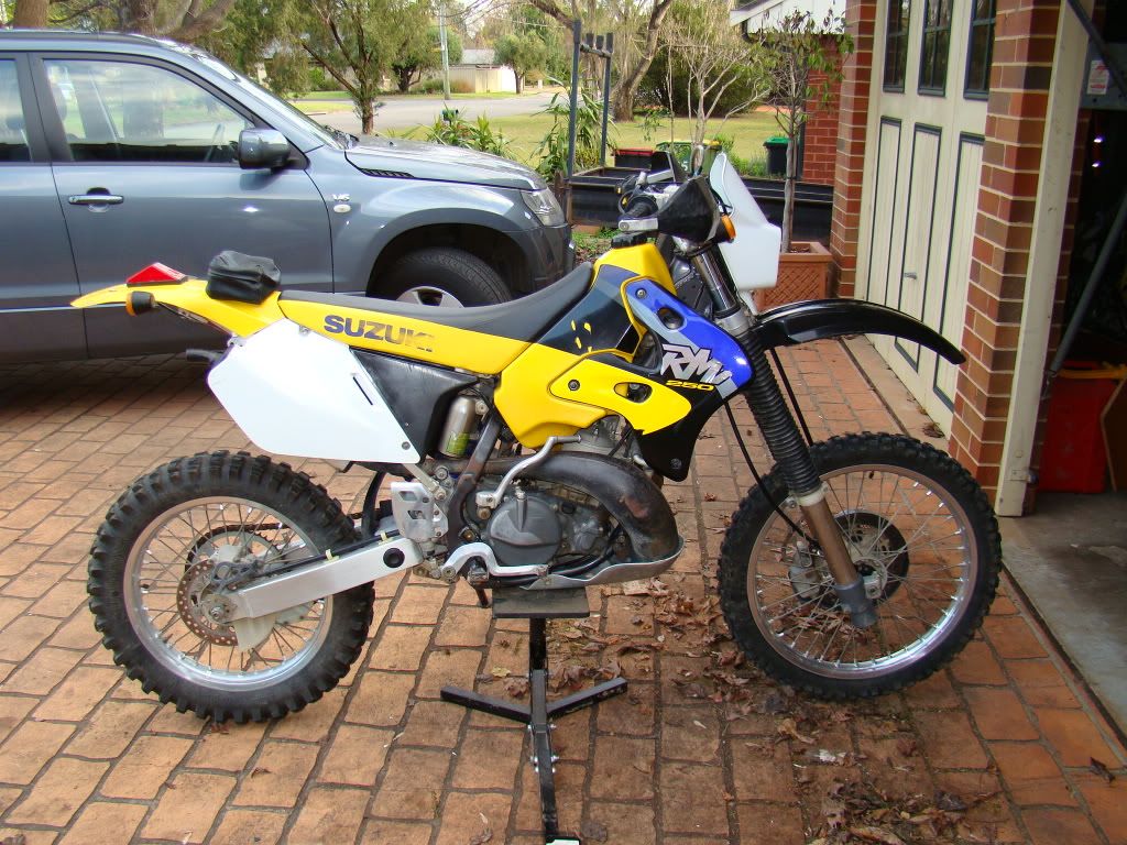

    I found one that looked promising. 1999 model with less than 2500km. Same owner since it was 5 months old. Recons it has had little use in the last nine years. I went for a drive up the coast today and had a look. The owner was unable to get it to fire up as it’s been sitting for a while. As he also owns a DRZ400 I knew he would be trustworthy sort of bloke so I took a punt it wouldn’t take much to get it going. Other than that she looked in great shape for a 12 year old bike. Also has a nice bash plate, Barkbusters and Renthal bars.
    A deal was cut and a 1999 RMX250 was on my trailer for $1800.

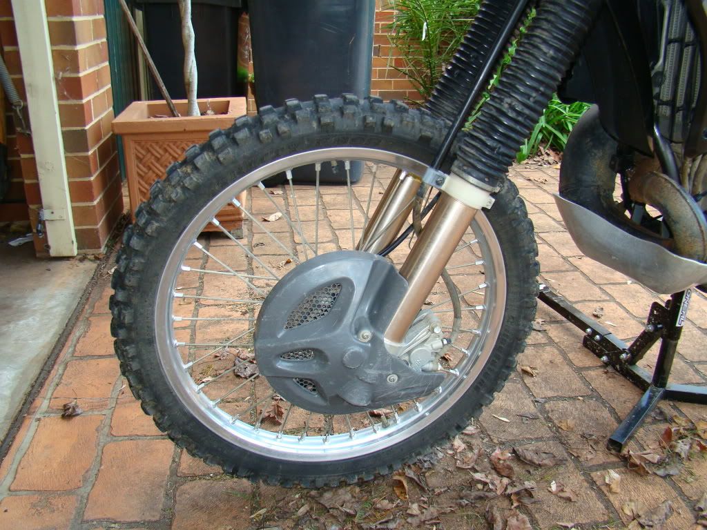

    Still had the front disc guard.
    I dropped into Suttos on the way home and picked up some of that two smoke oil and a new plug. Got the old girl home, drained the tank. Pulled the carby off and gave it a clean. The bowl had water in the bottom. Screwed in a new plug. Put it all back together and with only two kicks that unmistakable sound of an angry two stroke could be heard resonating from Scotty’s shed. Love the simplicity.
    Took it for a couple of laps of the street (apology to the neighbours). Feels very similar to the DRZ. A bit like the DRZ’s skinnier, angry little sister.

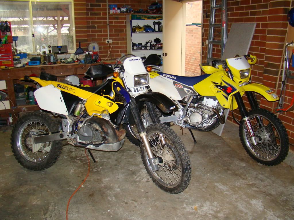

    Stable mates.

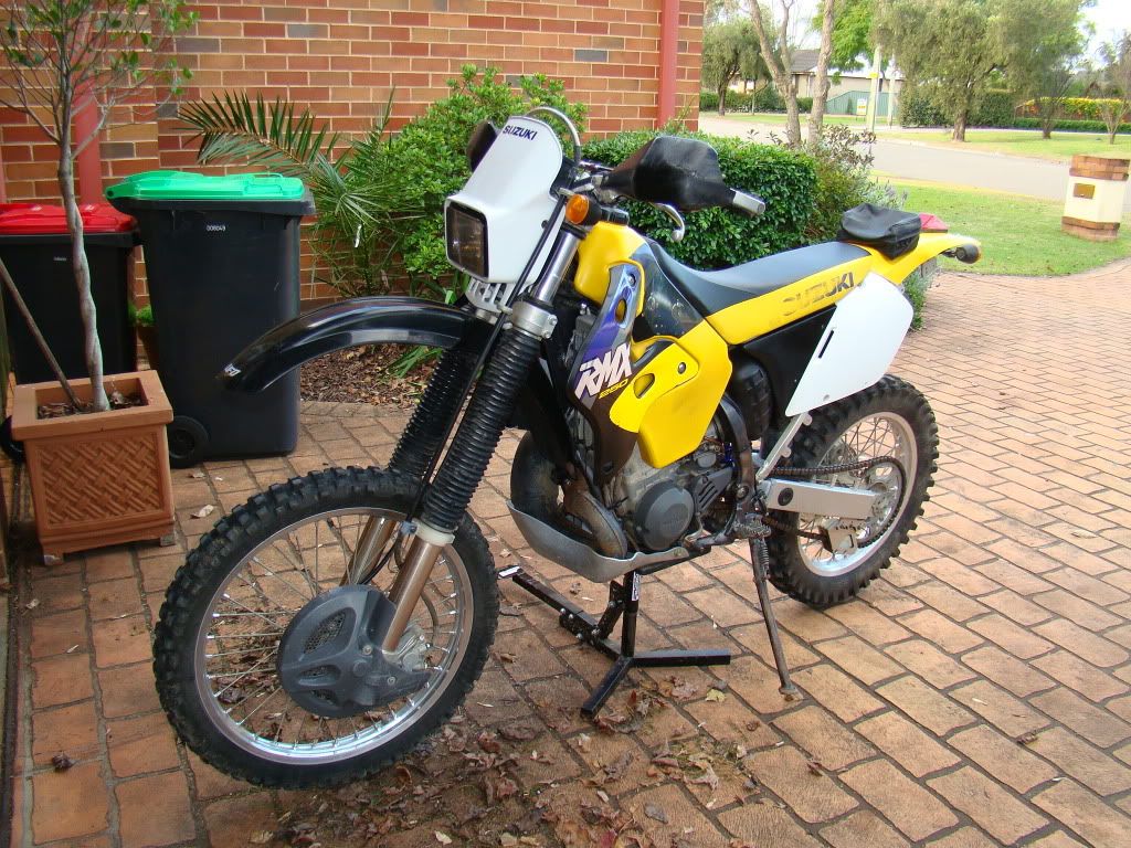

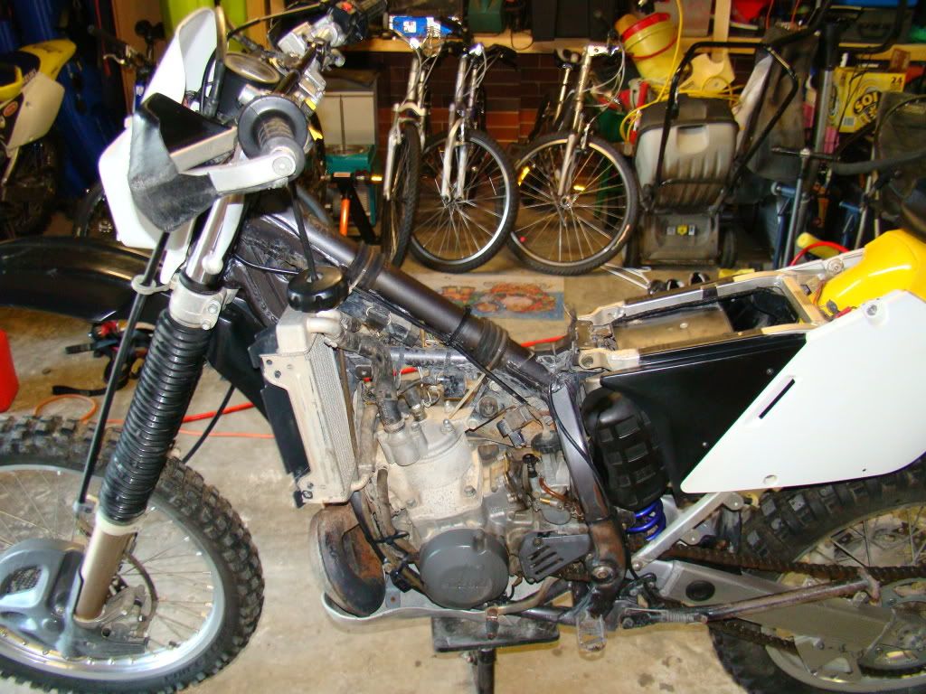

    The short term plan is to give it a good service, oils, brake fluid, regrease swingarm and headset and put some decent tyres on it, (the front is the original 12 year old tyre), change the bulky head light for the RMX enduro one I already have, than get it out for a ride to see how it feels.
    For the long term I think I might strip it back to the frame and rebuild it. Paint the frame and any other parts that need cleaning up. No doubt the suspension will get the Teknik’s treatment. I also see there is a common carby swap which makes jetting much easier. I think the wheels would look nice anodised black. Now who do I know who can relace wheels, cough TB cough.
    I think it is the makings of a good project and will make a great trail bike with a bit of work.

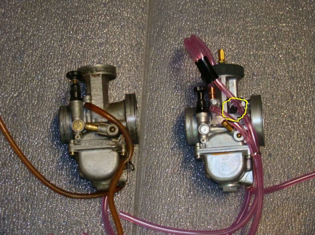

    Also interested in the Airstriker carb for my RMX,My main problem with the old one is that,after you give it a bit of a stab,then try to back off, it dosn’t want to idle down right away,the engin wants to run on.This tendencey bought me to greaf this year,with a bad result. Now I just dab in a bit more rear break to slow it down,but not enough to stall it,this is a drag,cose yu shouldn’t have to fight it.
    I’m told that the reason for this is that the choke and the idle jet are in the same port. Question, dose the 38 mm Airstriker have a seperate idle scew??? Looking at pics of it ,it looks the same as the stock carb.
    For $360. I’d be looking for a good result.
    Thanks Teza.
    #204008

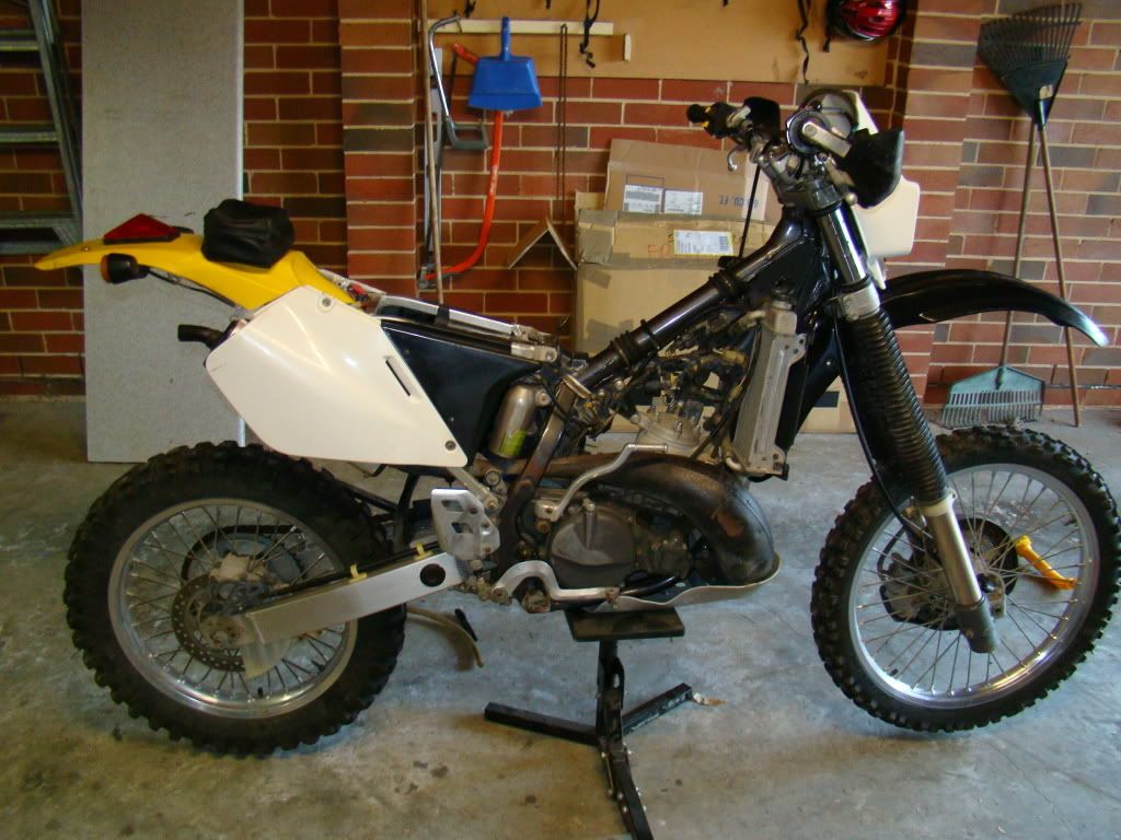

    Well I called Mainjet Motorcycles on Wednesday and spoke with Leah. He was very helpful. I ordered a 38mm Keihin Airstiker prefitted with a JD jet kit, $359 with free express post. Was on my doorstep Friday. Awesome service.
    Old vs New. The big difference is the idle screw is now separate from the choke. It’s hard to see but the black screw circled in yellow is the idle screw.
    A got time to have a play in the shed this afternoon and got the new carb fitted. Took a bit of modifying the cable as I also fitted a whirlpool throttle assembly.
    All fitted fired up with a couple of kick. Once it was warmed up a couple turns in on the idle screw and the RMX was idling nice and would cleanly rev with the crack of the throttle and setting back to idle.
    Once warm, only takes a little bit of throttle and fires up first kick. As it was getting late and was now dark outside I only went for one run up the street and back but felt good. I’m now looking forward to getting the RMX out in the dirt to see how it goes.
