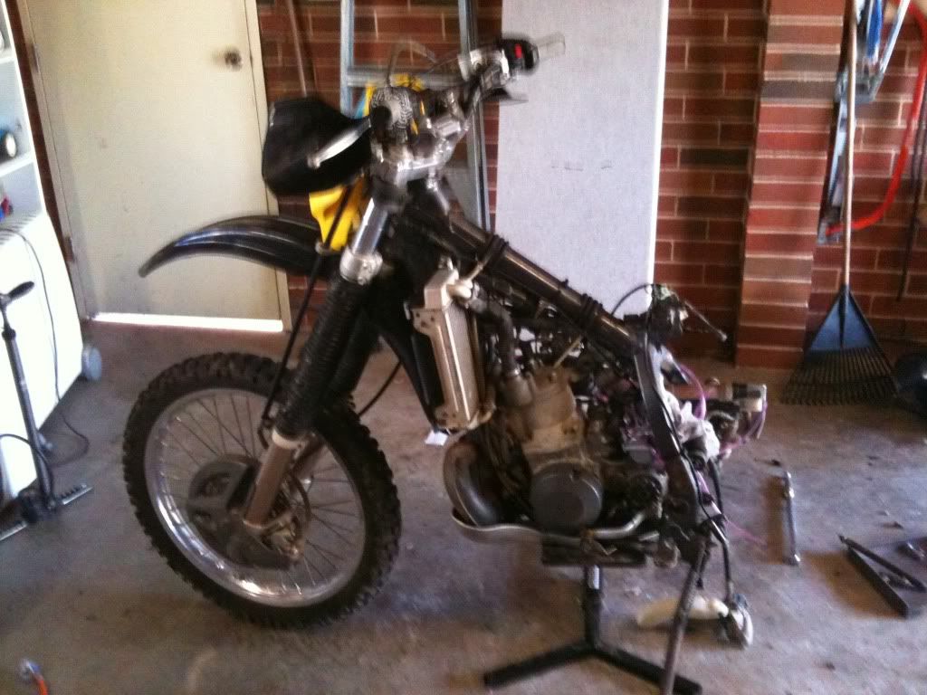

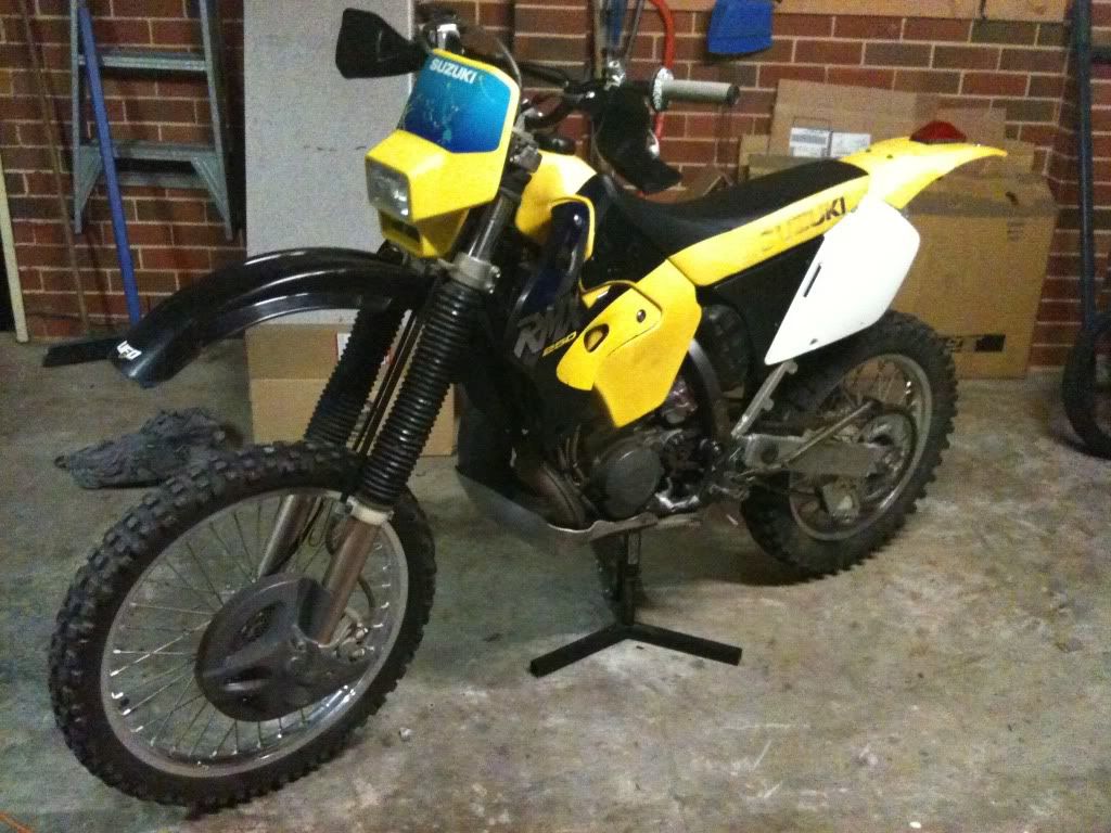

    Got some long overdue maintenance done on the RMX today. Pull down the rear suspension, cleaned and greased all the swing arm and linkage bearings. Looks like it has been a long time since the rear wheel was been off. The axle took some massaging to get out, would of been interesting if it was out on the trail changing a flat.
    Replaced the ugly ADR headlight with a proper RMX unit. Added some high bend bars, new grips and removed the Barkbusters putting the original hand guards on. Pulled the blinkers off for now as it wont be getting registered just yet.
