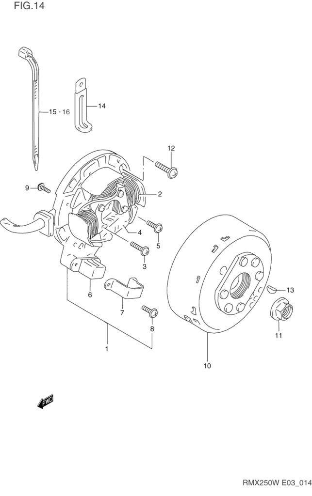

    Just did some searching and found a guy who build a 99 RMX250 motard. He had a screw back out of stator which caused a screeching noise. Could I be so lucky it will be this simple?

    Before I even read down this far, I had put my money on this being the cause of the noise. I had a similar thing happen to an RD250LC, it made a wild grinding noise untill the screw “caught” and bent at 45 degrees which then stopped it from hitting the stator rotor, hence no more noise.

    I am thinking that either screw 3, 5 or 12 has come adrift.

    Like Michael says something adrift in the flwheel stator area.

    Same thing happened to my RMX back in the day, Screw 3 was loose

    Well, the mystery continues. I borrowed a puller this morning and pull the flywheel off. No signs of any issues under here. All screws in place as they should be and no sign of anything rubbing on the flywheel either inside or out.
